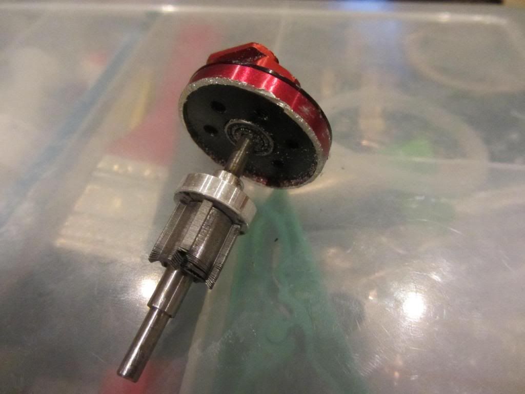

the stock motor can't handle 3s at least in my experience. I ran mine with a 3s 20c 1600mah turnigy lipo and suddenly the car had a grinding sound. At first, I thought it was the diffs but check them and everything was fine. Ran the motor and I think it seized? I'm not an expert but it think it has something to do with the magnet? or it ran too hot?
Here what's left of it. Tried to cut the can to remove the stuck motor mount..
I can't remove the motor mount, it think they placed red Loctite in the motor screws

Which outrunner are you running? Be careful if it's a high KV 6 pole motor, I burnt out my first outrunner when running it with the stock ESC on 3s.

I don't know for sure but I suspect the Hobbywing ESC has a 40000 RPM limit with 6 pole motors which would explain why it works with 2s (31920 RPM) but not 3s (47880 RPM).

Thanks rcwilly. I learned something new and good to know before running the hobbywing ESC on 3s. Don't want to replace another motor..
